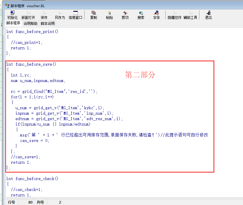

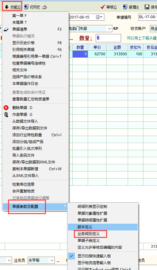

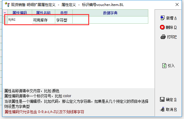

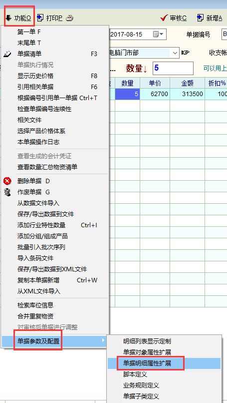

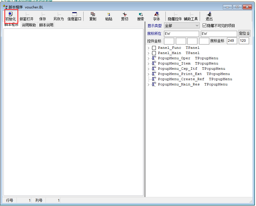

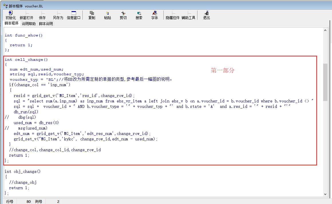

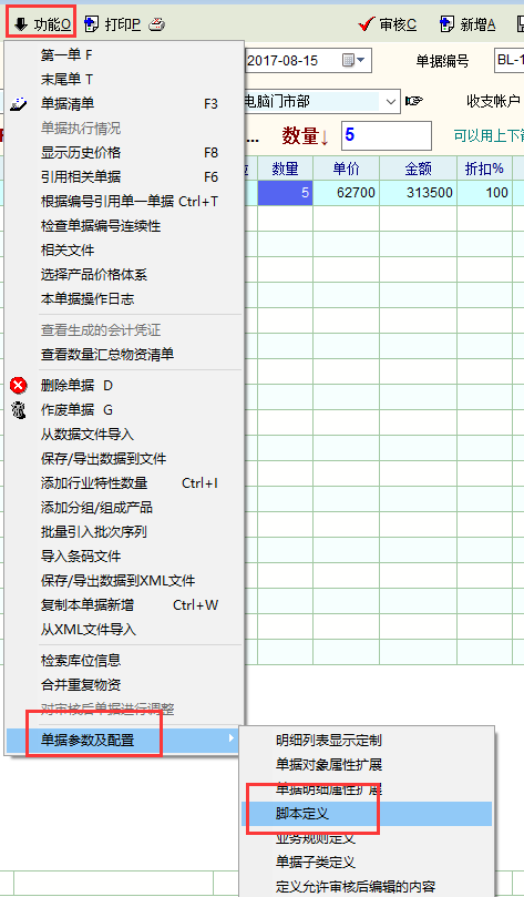

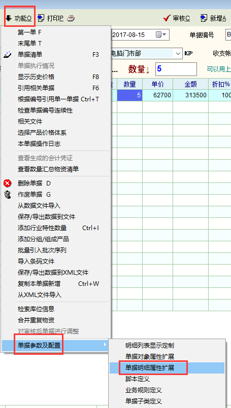

见图示的 几个步骤:
第五步:黏贴或附加下列脚本的两个部分按顺序到示例图红框处替换到原来的脚本:
第一部分:
int cell_change()
  num edt_num,used_num;
  string sql,resid,voucher_typ;
  voucher_typ = 'BL';//将BB改为所需定制的单据的类型,参考最后一幅图的说明。
  if(change_col == 'inp_num')
    resid = grid_get_v('MG_Item','res_id',change_row_id);
    sql = "select sum(a.inp_num) as inp_num from ebs_vr_item a left join ebs_v b on a.voucher_id = b.voucher_id where b.voucher_id <> "
    sql = sql +  voucher_id + " AND b.voucher_type = '" + voucher_typ + "' and b.state = 'A'  and a.res_id = '" + resid + "'"
    db_run(sql)
//    dbg(sql)
    used_num = db_res(0)
//    msg(used_num)
    edt_num = grid_get_v('MG_Item','edt_res_num',change_row_id);
    grid_set_v("MG_Item",'kykc', change_row_id,edt_num - used_num);
  //change_col,change_col_id,change_row_id
第二部分:
int func_before_save()
  int i,rc;
  num u_num,inpnum,edtnum;
  rc = grid_find("MG_Item",'res_id','');
  for(i = 1;i<rc;i++)
    u_num = grid_get_v('MG_Item','kykc',i);
    inpnum = grid_get_v('MG_Item','inp_num',i);
    edtnum = grid_get_v('MG_Item','edt_res_num',i);
    if(inpnum>u_num || inpnum>edtnum)
      msg('第 ' + i + ' 行已经超出可用库存范围,单据保存失败,请检查!')//此提示可自行修改
      can_save = 0;
  //can_save=1;

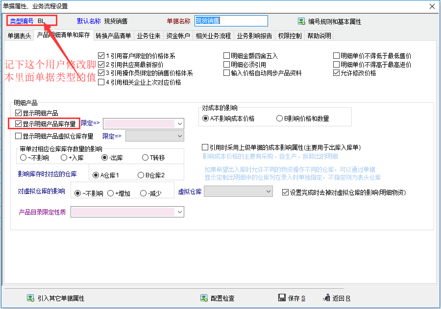

记住最后一步二箭头所示类型编号以便修改脚本
